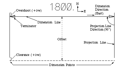

The Projection Line Clearance (PLCL) is the distance between the dimension point and the projection line at the dimension point end. Negative clearances may be specified. Examples of setting this attribute are:
- set PLCL to 5mm
- set using cursor
- (at Dimension Point level): set to owning Dimension PLCL value
PLCL may be set at Dimension or Dimension Point level. PLCL set at Dimension level (which becomes the ‘default’ PLCL) will apply to all subsequently created Dimension Points. PLCL set at Dimension Point level can only be reset from the same Dimension Point, not from Dimension level. When setting PLCL with the cursor, the resulting (paper) coordinate that does not lie in the same axis direction as the projection line is ignored. These comments also apply to the OSHT attribute.
The Projection Line Overshoot (OSHT) is the distance by which the projection line ‘overshoots’ the end of the dimension line. Negative overshoots may not be specified. Examples of setting this attribute are:
