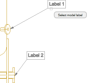

You are prompted to Specify alignment mode <Vertical>
Input V at the prompt and press Enter to align the labels vertically.
You are then prompted to Select extended mode <Standard>
Input S at the prompt and press Enter to align the labels using the standard format. The angle of each leader line is not preserved.
You are then prompted to Select model label
You are then prompted to Select labels to align
