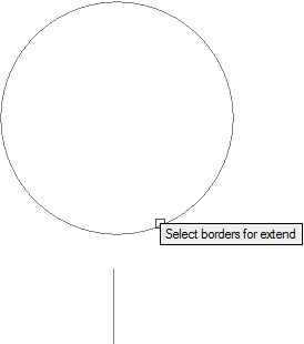

To extend objects, on the Draw tab, in the Modify group, click Trim, select Extend from the drop-down list.

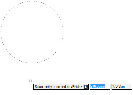

The user is prompted to Select borders for extend

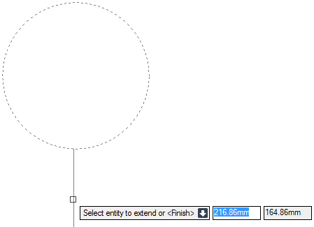

The user is then prompted to Select entity to extend or <Finish>
Input F at the prompt and press Enter to end the command.
