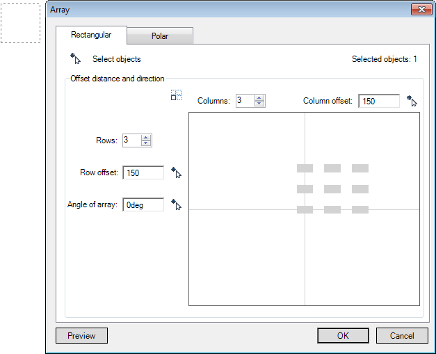

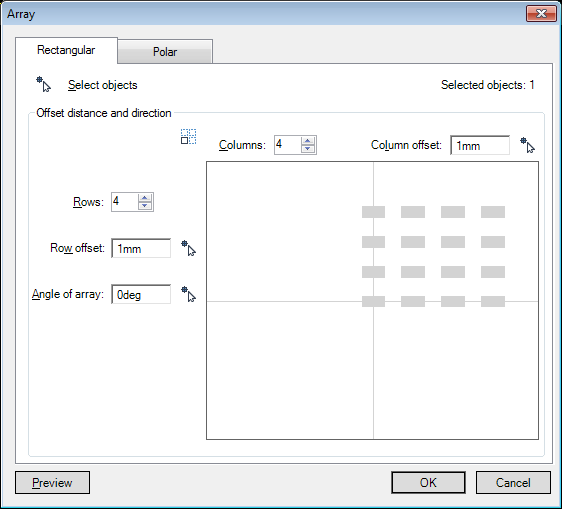

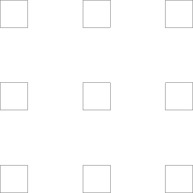

Select the Rectangular tab to create a Rectangular Array.
Click to display a preview of the array with the current settings. The Array window is closed and the preview displays on the drawing canvas.
Press ESC to return to the Array window or Enter to create the array.
The Array window is closed and the user is prompted to Specify unit cell
Input values in the dimension fields and press Enter or click to identify the start point of the unit cell.
Input values in the dimension fields and press Enter or click to identify the other corner of the unit cell.
The Array window displays, the Column offset and Row offset fields are populated with the identified offset distances, by default.
Click next to the Column Offset field to specify the column offset distance on the drawing canvas.
The Array window is closed and the user is prompted to Specify the distance between columns
Input a dimensional value in the field and press Enter to specify the distance between columns or click to identify the first point to specify the distance between columns.
The user is then prompted to Specify the second point or <Change reference point>
The Array window displays and the Column offset field is populated with the column offset distance, by default.
Throughout the column offset process the user can press ESC to cancel the command. Additional functionality is also available.
Press the down arrow key and select Change reference point to modify the existing offset reference point.
Click next to the Row Offset field to specify the row offset distance on the drawing canvas.
The Array window is closed and the user is prompted to Specify the distance between rows
Input a dimensional value in the field and press Enter to specify the distance between rows or click to identify the first point to specify the distance between rows.
The Array window displays and the Row offset field is populated with the row offset distance, by default.
Throughout the row offset process the user can press ESC to cancel the command. Additional functionality is also available.
Click next to the Angle of array field to specify the angle of array on the drawing canvas.
The Array window is closed and the user is prompted to Specify array angle
Input an angular value in the field and press Enter to specify the array angle or click to identify the first point to specify the array angle.
The Array window displays and the Angle of array field is populated with the array angle, by default.

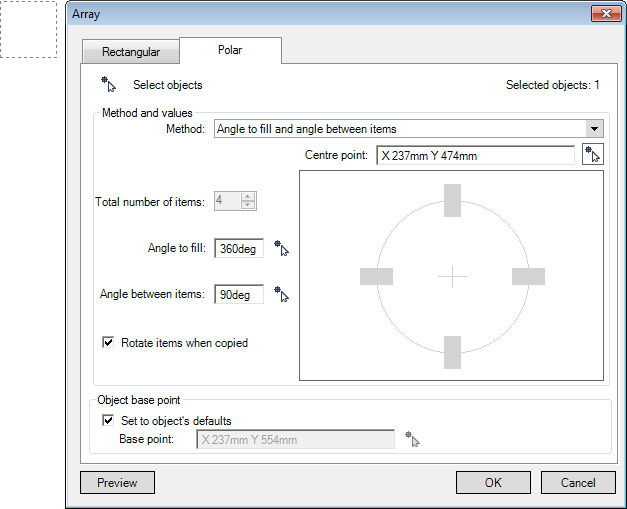

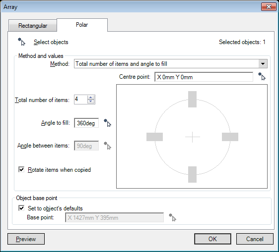

Select the Polar tab to create a Polar Array.
Press ESC to return to the Array window, or Enter to create the array.
Click OK to create the Array or Cancel to discard any inputs and close the Array window
Click next to the Centre point field to specify the array centre point on the drawing canvas.
The Array window is closed and the user is prompted to Specify centre point of the array
Input values in the dimension fields and press Enter or click to identify the centre point of the array.
The Array window displays and the Centre Point field is populated with the centre point coordinates, by default.
Click next to the Angle to fill field to specify the angle to fill with array objects on the drawing canvas,.
The Array window is closed and the user is prompted to Specify the second point (the first point is the previously defined centre point).
Input an angular value in the field and press Enter or click to identify the second point to specify the angle to fill.
The Array window displays and the Angle to fill field is populated with the angle to fill value, by default.
Click next to the Angle between items field to specify the angle between array objects on the drawing canvas.
The Array window is closed and the user is prompted to Specify second point (the first point is the previously defined centre point).
Input an angular value in the field and press Enter or click to identify the second point to specify the angle.
The Array window displays and the Angle between items field is populated with the angle value, by default.
Click next to the Base point field to specify the base point coordinates to rotate objects around.
The Array window is closed and the user is prompted to Specify the object's base point
Input values in the dimension fields and press Enter or click to identify the base point.
The Array window displays and the Base point field is populated with the base point coordinates, by default.
