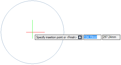

To paste to the same or different sheet/view at a specified position, on the Home tab, in the Tools group, click Paste, select Paste from the drop-down list.
The user is prompted to Specify insertion point or <Finish>
Input values in the dimension fields and press Enter or click to identify the position of the pasted objects.
Input F at the prompt and press Enter to end the command.

To paste the objects, on the Home tab, in the Tools group, click Paste, select Paste from the drop-down list.
Input values in the dimension fields and press Enter or click to identify the base point relative to which the objects are pasted.

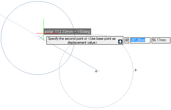

To move objects using the Move command, on the Draw tab, in the Modify group, click Move.
The user is prompted to Select objects to move
The user is then prompted to Specify base point or <Displacement>
Input values in the dimension fields and press Enter or click to identify a base point relative to which the objects are moved.
The user is then prompted to Specify the second point or <Use the first point as displacement>
Input values in the dimension fields and press Enter or click to identify the new location of the objects.

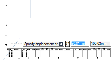

Press the down arrow key and select Displacement to move the objects, relative to the zero point of the user coordinate system. Refer to Move Objects using Move Command and Displacement Position for further information.
The user is then prompted to Select objects to move
Input D at the prompt and press Enter.
The user is then prompted to Specify displacement or
Input values in the dimension fields and press Enter or click to identify the new location of the objects.The displacement between the new object position and the original is determined by the position of the cursor with relation to the zero point of the user coordinate system.
