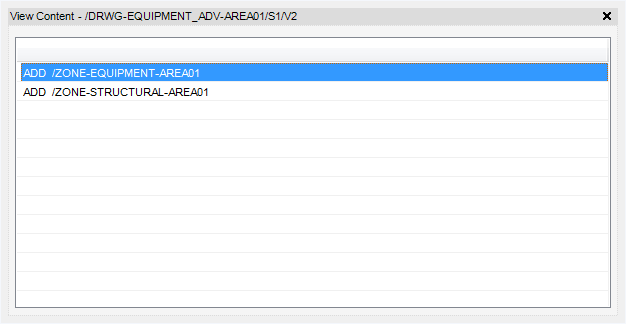

To display the contents of the 2D drawlist, on the
3D Format tab
, in the
Manage
group, click
View Contents
to display the
View Content
window.
The
View Content
window displays the elements that have been added to the
2D
and
3D
views.
To remove the currently selected element, right-click and select
Remove Selected
from the drop-down menu.
