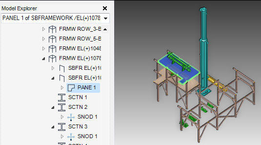

The 3D view window in DRAW allows the user to assemble and manipulate Design elements to populate drawing sheets.
The user can examine the content of the drawings in 3D view, before establishing the view content as a 2D drawing.
However, the 3D view window also offers powerful facilities to enable the manipulation of 2D drawings.
To open a view in the 3D view window, make the view the CE, on the
Format 2D
tab, in the
Modify
group, click
Edit in 3D
By default, the Model Explorer and the
Format 3D
tab (refer to
Format 3D Tab
for further information) display when a 3D view is opened.
When an element is selected in the 3D view, it is highlighted in the Model Explorer and vice versa.
