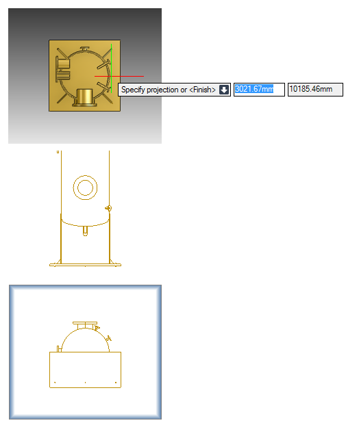

To create an orthographic projection view of the objects in an existing 2D view, on the Home tab, in the View group, click Projection, select Projection from the drop-down list.

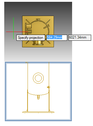

Input values in the dimension fields and press Enter or move the cursor the required distance away from the original view, click to confirm the location of the new view. The projection view is created at that point.
The user is then prompted to Specify projection or <Finish>
Input F at the prompt and press Enter to end the command. The projection view is created.
Throughout the view creation process the user can press ESC to cancel the command. Additional functionality is also available.

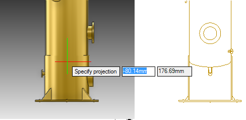

To create a projection view without generating a preview image display, on the Home tab, in the View group, click Projection, select Quick Projection from the drop-down list.
Alternatively, select a view, on the Format 2D tab, in the View group, click Projection, select Quick Projection from the drop-down list.
The rest of the procedure is as described in Create Projection View, the difference being that a shaded area displays instead of a preview image.
