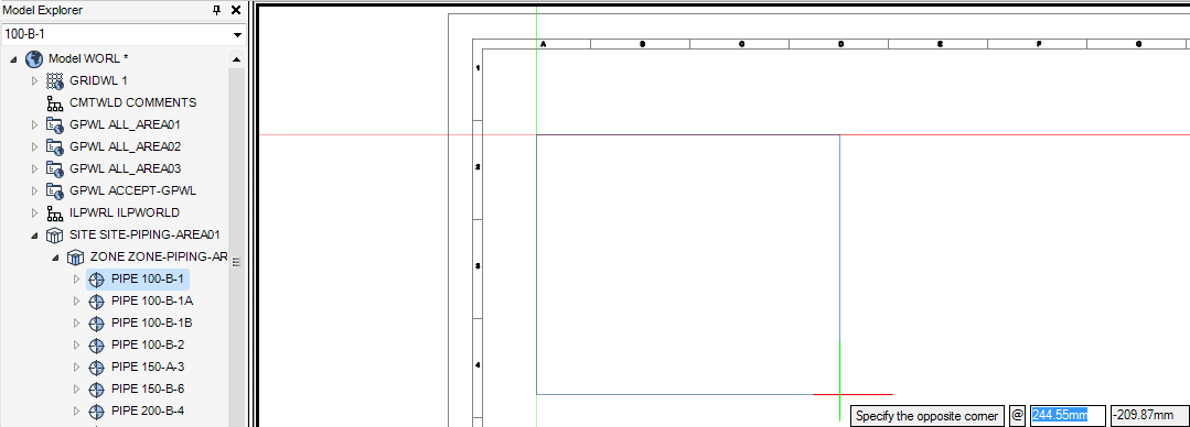

The user is prompted to Specify the first corner or
Input values in the dimension fields and press Enter or click to identify the first corner of the view.
The user is then prompted to Specify the opposite corner
Input values in the dimension fields and press Enter or click to identify the opposite corner of the view. The view is created.

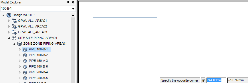

Input C at the prompt end press Enter.
The user is then prompted to Specify centre point or
Input values in the dimension fields and press Enter or click to identify the centre of the view.
Input a dimensional value in the field and press Enter or move the cursor left or right to define the width of the view. Click to confirm the required width.
Input a dimensional value in the field and press Enter or move the cursor up or down to define the height of the view. Click to confirm the required height. The view is created.
