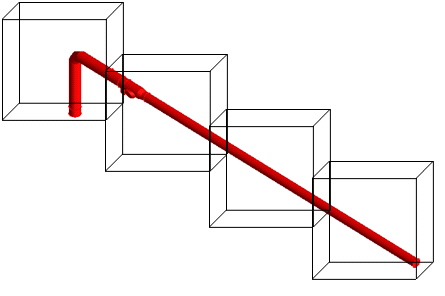

By Volume
Isometric ADP uses predefined boxes (volumes) to define the content of each spool.
Changing the size of the box, enables the user to choose the level of complexity of each spool. The content of each drawing is not preserved and changes made to the branch can affect all existing drawings.
