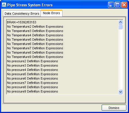

From the Existing Group box, right-click the selected Stress Group and select Show Node Details from the drop-down menu. The Node Details window is displayed.
Select the component that needs the weight to be changed. (If the weight is zero, the Error column will be flagged as True in the Node Details window).
Select Display > Node Attributes.

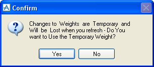

The Node Number ARRAY window is displayed with the majority of the fields being read-only. However if the weight is zero then the weight field can be changed. Change the weight to a suitable value, and select Apply. A Confirm window is displayed warning that the changes made by this method are only temporary.
Click Yes to change the weight or No to cancel the changes.

Although CAESAR 11 will allow up to nine temperatures and pressures, by default the Pipe Stress Interface only transfers one temperature and pressure, therefore error messages for temperature 2 - 9 can be ignored. If no insulation has been set on a branch any error in insulation can be ignored.
To close the Node Details window, click Dismiss.
