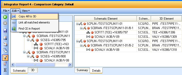

Integrator can automatically update attributes on matched or linked objects from a report. Click on
Edit > Copy All to 3D
Figure 5:23.
Copy all to 3D

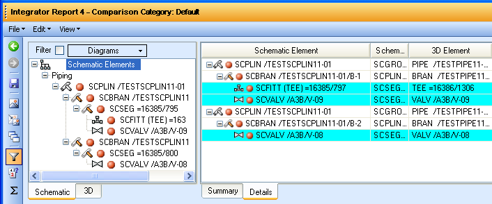

Integrator will work through the report content updating any attribute differences on linked or matched objects. On completion, the report will indicate newly updated objects in cyan and any failed or skipped updates in red.
Figure 5:24.
Results of Auto-updating Attributes
A log of the updating actions is output to the command line.
