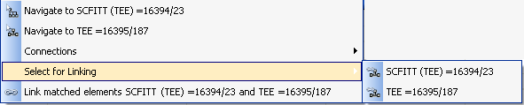

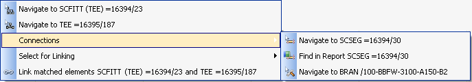

The context menu is available by clicking the right hand mouse button within the Report form panels. There will be different options available depending on whether the object is linked or matched or neither.

Connections
Navigate to connected object or focus the report on connected object
Select for Linking
Select this object for linking - its name will be displayed in the report status bar
Link <named objects>
Link the currently selected object to the object previously selected for linking
Link matched elements <names>
Link the matched objects
