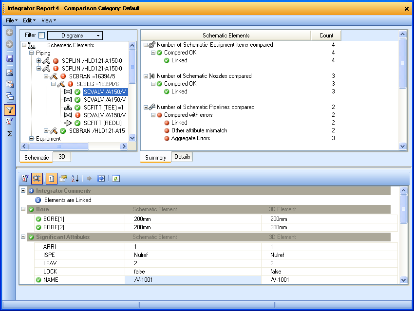

The Comparison Report form provides options to explore, view, filter, save and act on the report content. The details of the Compare function are described in detail in
Integrator Functions in Detail
, including illustrations of the report content.
The Report form has explorer style tree and grid panels and an attribute data panel. It has
File
and
View
bar menu entries and a toolbar controlling the main options.
Context specific options are available from right click menus in the grid and data panels.
Icons give an immediate indication of where there are differences to be reported. The specific differences are reported in the Data Panel when an object is selected.
Figure 4:26.
Comparison Report
