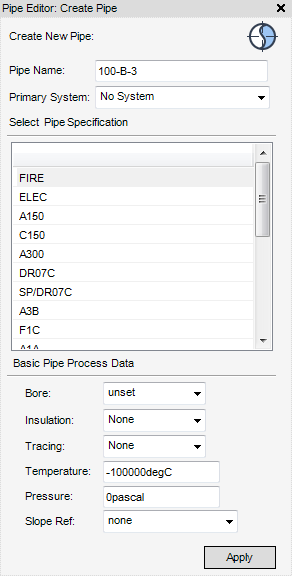

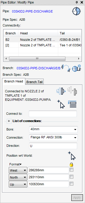

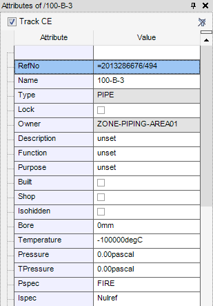

To create a Pipe element, on the Piping tab, in the Create group, click Pipe to display the Pipe Editor: Create Pipe window. To define the pipe, refer to Create Pipe for further information.
The user can modify the pipe attributes. Refer to Common Functionality User Guide for further information.

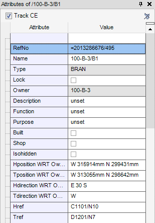

To view the pipe attributes, with the pipe selected as the CE, on the Piping tab, in the Common group, click Attributes list to display the Attributes window.

To view the branch attributes, with the branch selected as the CE, on the Piping tab, in the Common group, click Attributes list to display the Attributes window.

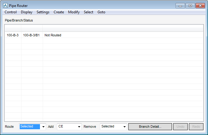

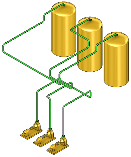

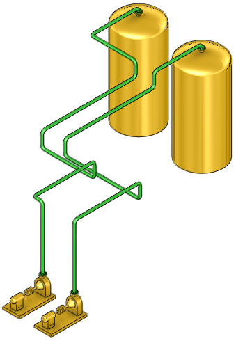

The user must now add the pipes to the Pipe Router window, and then route the pipes, Pipes can be added individually or in groups.

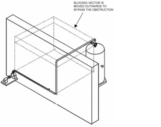

By default, the Pipe Router routes pipes in the order in which they are added to the Pipe Router window. The routing order can have an effect on the route taken by pipes. Refer to Changing the Order in which Pipes are Routed for further information. Pipe Router routes the selected pipes, adding elbows, gaskets and flanges, as required.
The Pipe Router creates a route using an algorithm which minimises material cost while avoiding clashes with other objects. The algorithm has three modes of operation, described as Level 1, Level 2 and Level 3 modes. Pipe Router first searches for a route using Level 1 mode. If no clash-free Level 1 route is found, a search is made using Level 2 mode, and if no Level 2 route is found Level 3 mode is used.

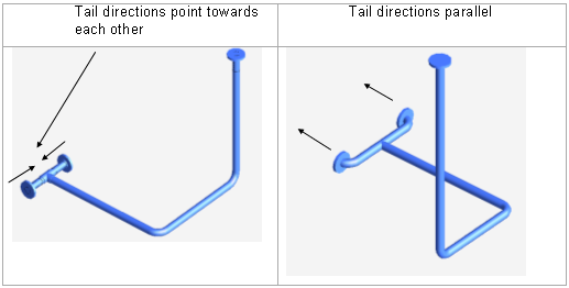

How Pipe Router Routes to Free Tails
If this fails, for example, because there is a clash or a component positioning rule cannot be satisfied, then it introduces an Elbow after the constraint, before the first component. Pipe Router then positions the elbow in a direction that results in a clash-free route, and which satisfies component positioning and orientation rules.

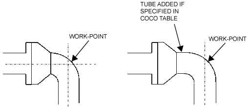

Tail direction: The TDIR attribute for a free tail is never set if the last constraint is a plane or a rack. In all other cases, TDIR is taken from the direction of the last component.

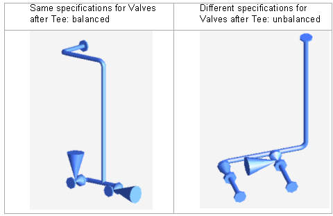

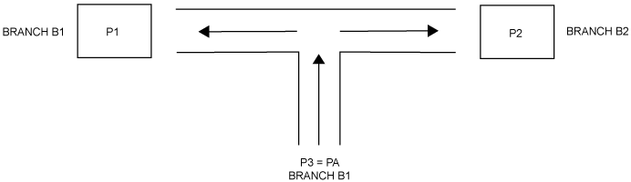

The Tee must be symmetric about a plane through P-arrive. The Pipe Router changes the arrive p-point to achieve this if the bores on the p-points are equal. It then checks the leave-bore and connect-bore. If the bores are equal then Pipe Router assumes that the Tee is T-shaped.

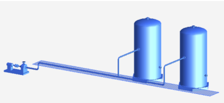

In Pipe Router, a pipe rack is composed of a group of routing planes which enables the user to model the route used on a physical pipe rack. There are two ways in which the user can create a pipe rack. The user can create pipe racks on existing steelwork structures or model them as a group of planes.

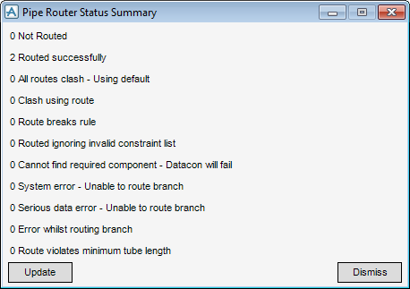

Once the pipe(s) have been routed, the user can check the status of the branch, by selecting Display > Status Summary from the Pipe Router window to display the Pipe Router Status Summary window. The Pipe Router Status Summary window shows that two Branches have been routed successfully.
Note:
Update and Dismiss at the bottom of the Pipe Router Status Summary window can be used to update the report file or close the Pipe Router Status Summary window.

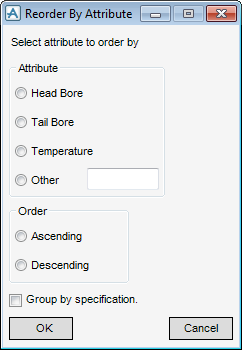

By Attribute - The user can reorder pipes according to particular attributes in ascending or descending order, using the Reorder by Attribute window.
To reorder pipes according to their specification, select Group by specification check box, the display is reordered in alphabetical order of their specification names, for example, all pipes which use the specification A150, followed by all pipes which use the specification B150, and then the other pipe specifications in the sequence. The user can use this option in conjunction with the attribute radio buttons.

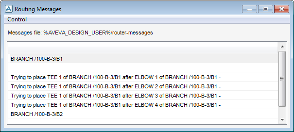

As Pipe Router routes a pipe, it examines each branch and generates a message about any routing errors that it finds. These messages can help the user understand and correct errors. It can view these messages both during and after pipe routing, providing the user has set up a file in which to store the messages, as described previously.
To view routing messages, select Display > Routing Messages from the Pipe Router window to display the Routing Messages window.
The Routing Messages window is empty if Pipe Router routes all pipes without any errors.
Select Control > Close to close the Routing Messages window.

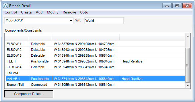

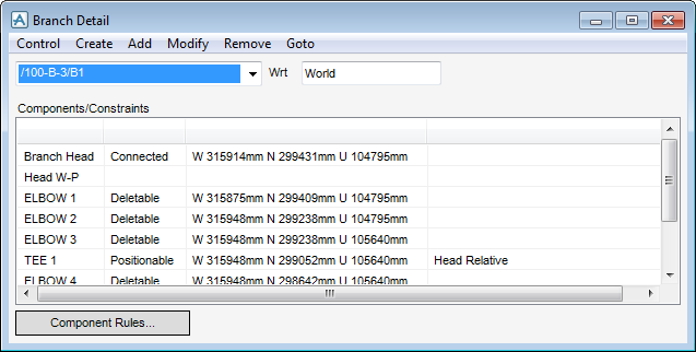

Pipe Router enables the user to view details of the components and constraints in a branch using the Branch Detail window. The user can select options to constrain the route taken by a branch.
Select one of the routed Branches from the Pipe Router window and click Branch Detail to display the Branch Detail window, which contains details of the selected branch.
Refer to Positioning and Locking Components for more information on the contents of the Branch Detail window.
Pipe Router sees all piping components as deletable, positionable or locked. If the Branch Detail window displays for a Branch that has been routed by the Pipe Router, all the components are listed as deletable.
After a Branch has been routed, components can be added manually in the normal way. Select the correct element in the Branch Members list, on the Piping tab, in the Create group, click Component to display the Piping Component Editor window. These components are described as Positionable. If the Branch is re-routed, these components are not deleted, but they may be moved to fit on the new route.
The order of Positionable components in the Branch Members list is maintained, and so is their order relative to any constraints in the Branch. For example, if a Valve is added before a Locked Tee, the Valve is not be moved past the Tee.

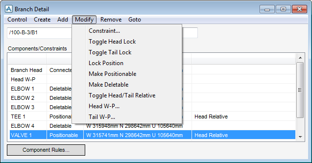

To change the status of a component, select it from the list on the Branch Detail window, and then select one of the options under the Modify menu on the window.
The choices are: Constraint, Toggle Head Lock, Toggle Tail Lock, Lock Position, Make Positionable, Make Deletable, Toggle Head/Tail Relative, Head W-P, and Tail W-P.

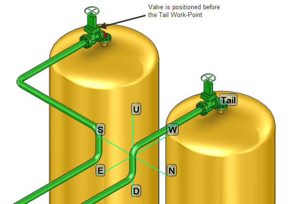

From the Branch Detail window, select Modify > Tail W-P to display the Modify Tail W-P window.
From the Modify Tail W-P window, select VALVE 1, click OK.
From the Pipe Router window, select the Route: Selected option.
Pipe Router re-routes the Pipe from the Head Work-point to the Tail Work-point, which is now positioned before VALV 1.
The user can check the position of the valve, display the Branch Detail window for the branch, then scroll to the bottom of the Components/Constraints list to display the details.

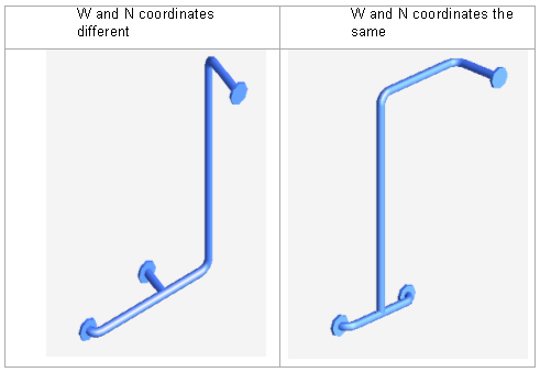

By specifying a different arrive and leave direction, the user causes a bend or elbow to be inserted at the position of the routing point. If a change of direction is not required, select the Through Direction and specify the direction for the pipe to take at that point. If the direction is unset, Pipe Router selects the best direction to minimise the number of bends or elbows used.

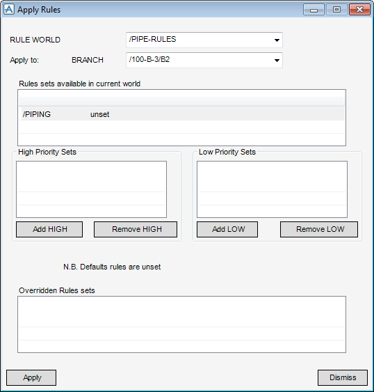

From the Pipe Router window, select Settings > Apply Rules > To Branch to display the Apply Rules to SELECTED window.
The user must first select the rule world which contains the rule sets to apply to the branch from the RULE WORLD list, which contains all the Branches selected on the Pipe Router window. From the Rule sets available in current world list, select the rule set. The rule set can be added as high priority or low priority.
Click Add HIGH to add the rule set to the High Priority Sets list or Add LOW to add the rule set to the Low Priority Sets list. Click Apply. The user must then route the branch to apply the rules.
From the Settings > Apply Rules options on the Pipe Router window applies the rule sets to a site, zone or pipe. In these cases all branches which are below them in the hierarchy also have the rule sets applied, unless they have rule sets specifically applied.
By default, Pipe Router applies all the rules in the specified sets to a branch, providing they are appropriate. However, the user can remove a rule from a particular component in a branch, or add one from another rule set.

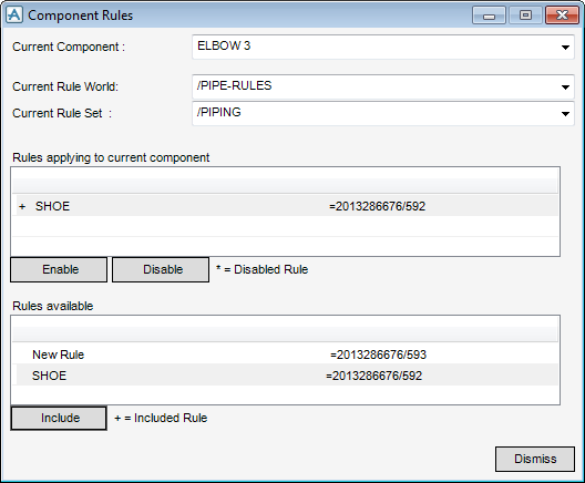

If required the user can apply a rule to a component from another rule world or rule set, from the Pipe Router window, select the branches to apply the rule to, click Branch Detail. From the Branch Detail window, click Component Rules to display the Component Rules window, which the user can use to add additional rules from the available rule sets, or from another rule world.
From the Rules applying to current component list, select the component that the rule is applied to.
From the Rules available list, select the rule the user wants to apply to the selected component, then click Include. The rule is added to the list of rules which apply to the component. Click Dismiss to close the Component Rules window.
The user can prevent Pipe Router from applying a rule to a particular component in a branch, from the Pipe Router window, select the branch which contains the component. Click Branch Detail to display the Branch Detail window. From the Branch Detail window, select the component from which the user wants to exclude the rule. Click Component Rules to display the Component Rules window.
From the list of rules that apply to the current component, select the rule to disable from the component, then click Disable. Pipe Router places an asterisk (*) to the left of the rule description to indicate that the rule is now excluded from being used.
If the user wants to re-enable a disabled rule, select the rule, then select Enable. The rule now appears in the Rules applying to current component list, preceded by a plus sign (+) indicating that it has been included.

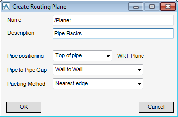

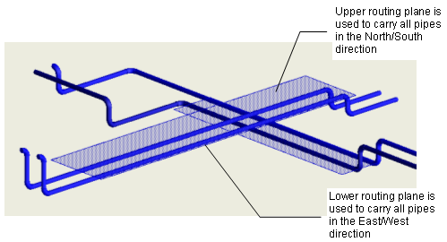

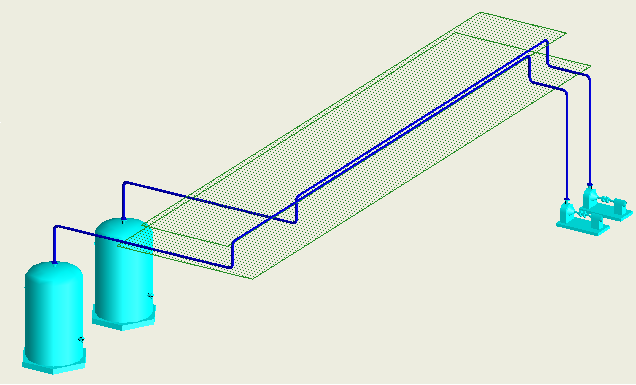

To create a routing plane make sure the STRU element is selected, from the Pipe Router window, select Create > Routing Plane to display the Create Routing Plane window, a routing plane element is created in the design hierarchy.
In the Description box, input the description of the routing plane, this text is not used elsewhere in AVEVA E3D™. (It may be useful for keeping a record of the plane’s purpose for future reference).
Top of pipe - Positions the top of the pipe on horizontal routing planes, or in front of vertical routing planes adjusting for any insulation. Top is the Z direction of the Plane which displays with an arrow.
Centre of pipe - Positions the centre of the pipe along the routing plane.
Bottom of pipe - Positions the side of the pipe below horizontal routing planes, or behind vertical routing planes, adjusting for any insulation.

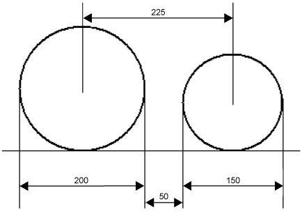

The Pipe to Pipe Gap and Packing Method options control how Pipes are packed on the plane., refer to Pipe Packing for further information. Click OK.

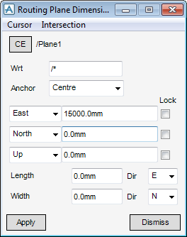

The Routing Plane Dimensions window displays.
The user can enter the coordinates on the Routing Plane Dimension window or use the other options available on the menu, which are similar to the normal AVEVA E3D™ positioning options.
In the Length box, input the length of the plane, from the Dir drop-down list, select the direction that the pipes are to be routed along wrt to the plane.
In the Width box, input the width of the plane, then set the direction wrt to the width of the plane.
Click Apply to create the routing plane or Dismiss to discard any inputs and close the Routing Plane Dimension window.

A vertical routing plane can be created by setting one of the Dir fields to be U or D (up or down). The up/front direction of the plane is indicated by a construction arrow in the graphical view which is drawn perpendicular to the plane. To reverse the direction, reverse either of the length or width directions, for instance from E to W.

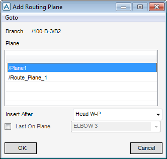

To route a branch via a routing plane, the routing plane must be added to the constraint list for the branch. From the Pipe Router window, select the branch to add the plane to, click Branch Detail to display the Branch Detail window, which contains details of the selected branch. Select Add > Routing Plane > Selection to display the Add Routing Plane window.
Click to check the Last on Plane check box to specify that positionable components are placed on the plane.
Click OK, the routing plane is added to the Components/Constraint list for the branch or Cancel to discard any changes and close the Add Routing Plane window.
Route the branches, using the Pipe Router, the branches are routed via the routing plane.

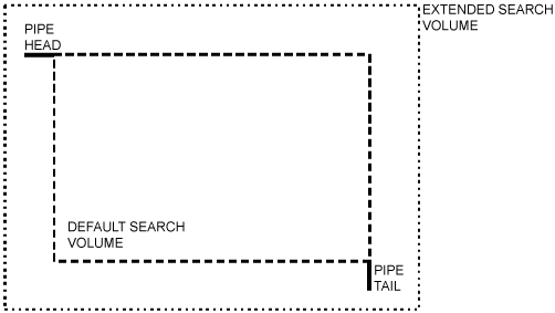

Planes are searched for in a box defined by the head and tail of the branch. The box is extended by the values specified in the Pipe Router Defaults window. Only pipes that travel along routing planes a distance greater than the Minimum Travel Distance are considered.
From the Pipe Router window, select the branch to add routing planes to, click Branch Detail. Select Add > Routing Plane > Automatically. The branches appear in the Command Input & Output window but not on the Status bar. The Components/Constraints list on the Branch Detail window are updated with the selected routing planes.
The Last on Plane check box on the Add Routing Plane window (and the Last on Rack check box on the Add Pipe Rack window) allows the user to specify that positionable and locked components are placed on the plane. When it is switched on, the neighbouring list shows all the positionable and locked components in the Branch: select the one required: all the positionable and locked components after the Plane, up to and including the component given as Last on Plane, are positioned on the plane.

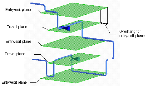

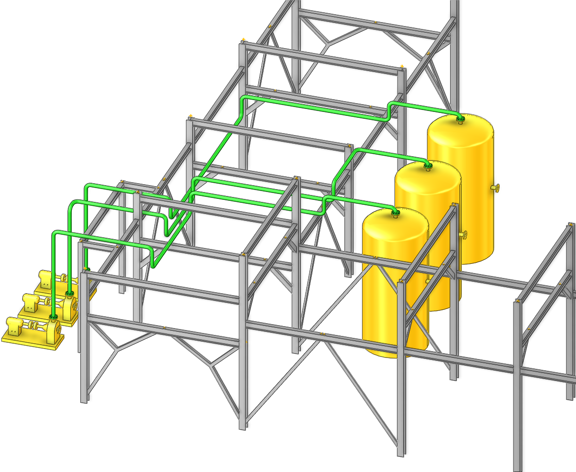

The user can create pipe racks with several levels, that is several travel planes. For each level of a pipe rack, a travel plane must be created to control the direction in which pipes travel along the rack and at least one entry/exit plane to make sure that pipes enter onto and exit from the rack perpendicularly, either from above or below. Each pipe rack must have at least one travel plane and at least one entry/exit plane. The direction of travel is the X direction (length) for travel planes and the Y direction (width) for entry and exit planes.
Pipe Router selects the closest pipe rack to the head in the search volume, whose direction takes the pipe closer to the tail, and providing that when using it, the pipe travels on the rack for longer than the Minimum Travel Distance as defined on the Pipe Router Defaults window.

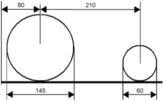

By default, Pipe Router runs pipes along Routing planes with the wall-to-wall Pipe Gap, with any rounding factor for the positioning, as given on the Pipe Router Defaults window. Refer to Pipe Packing for further information about how Pipes are packed on Planes and Racks.

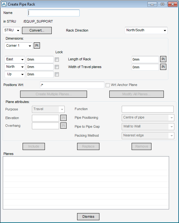

From the Pipe Router window, select Create > Pipe Rack Planes to display the Create Pipe Rack window.
In the Name box, input a name for the pipe rack, (the name of the STRU element which owns the pipe rack elements displays under the Name).

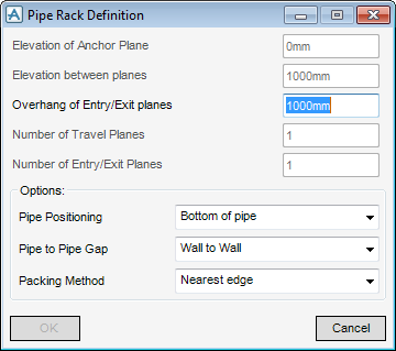

The user must select an element in the steelwork, click Convert to display the Pipe Rack Definition window and the user is prompted to pick an element in the steelwork to create the rack from.
Note:
The Anchor Plane is the lowest travel plane in the rack.
The Overhang of Entry/Exit planes can be changed. The default value is set on the Pipe Router Defaults window.
The user can set any Options to apply to all planes in the Rack. Refer to Pipe Packing Defaults for further information in Pipe to Pipe Gap and Packing Method.
Click OK on the Pipe Rack Definition window, the Planes part of the Create Pipe Rack window is now populated.

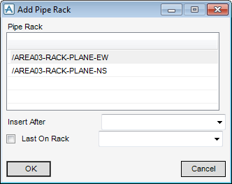

To manually add a pipe rack to the list of constraints for a branch, from the Pipe Router window, select the branch, select Modify > Branch > Add Pipe Rack > Selection to display the Add Pipe Rack window.
The Add Pipe Rack window contains a list of the pipe racks that are available for selection.
The user must select the required rack, click OK to add the rack to the Components/Constraint list for the selected branch or Cancel to discard any selections and close the Add Pipe Rack window.

If necessary the user can change the spacing using the additional pipe-specific gap on the Pipe Router Defaults window.

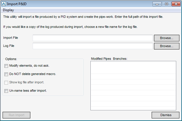

The user must navigate to the site or zone where to load the pipes from the P&ID. From the Pipe Router window, select Create > New Pipes from P&ID to display the Import P&ID window.
In the Import File text box, input the directory and file name of the P&ID file to load. Alternatively, click Browse to display the File Browser which contains a list of the available files, then select the required file.
If the user would like to keep a copy of the log file produced during import, in the Log File box, input a file name. Alternatively, click Browse to display the File Browser which contains a list of the available files, then select the required file.
The options can be defined by selecting from the Options part of the Import P&ID window:
Modify Elements, do not ask. - Pipe Router modifies Pipes and Branches which are in both the existing model and the P&ID file. If this option is not selected, the user is prompted to decide whether to modify the element or not. Minor elements (Valves, Tees and other minor components.) are made unnamed if they already exist, whether this set to on or off.

Messages generated are also output to the Command Input & Output window, if the window displays currently. The log contains messages relating to the progress of the import operation, and any errors or warnings. In particular, the Branch Head must be positioned, if the HREF is not set.
