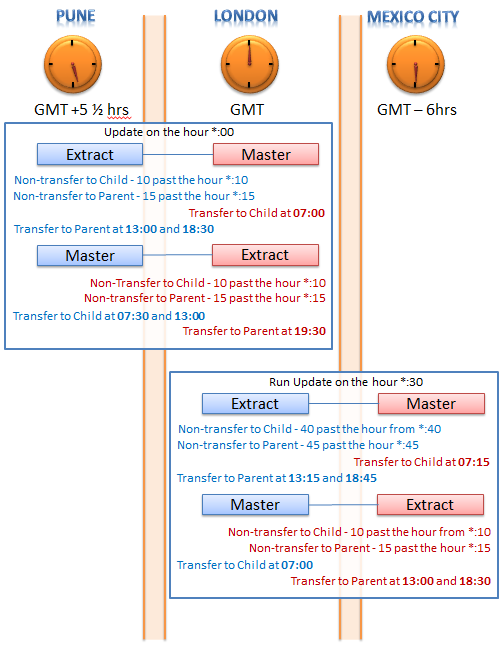

When locations reside in different time-zones the schedules need to be synchronised to allow for the shift in the time difference. In the example below there are three locations in Asia, Europe and the Americas. The diagram provides a possible set-up that makes sure data is shared between all locations regularly, with items location being transferred twice a day. The transfers try to follow the sun. The flow is to make sure that items are relocated on a half daily basis.
