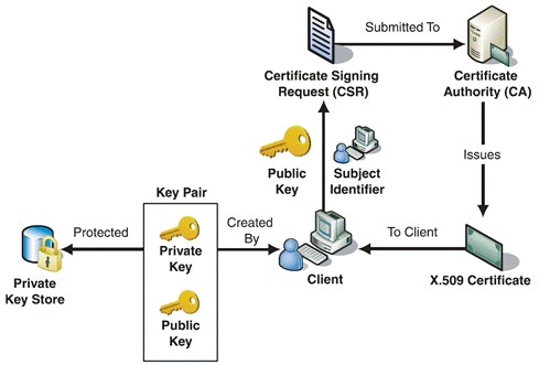

The user must install the certificate on Server machine.
The certificate on the Server machine will be validated against the root
Certification Authority
(CA) as shown below:
