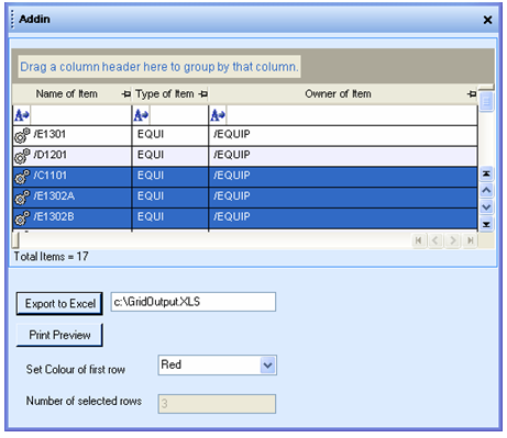

The addin creates the docked window shown below when run within the AVEVA E3D™/Marine Design module.
The example C# code collects all the Equipment items within the current project and lists them inside the grid along with attribute values for Name, Type, and Owner.
The data in the grid can be selected, sorted and filtered.

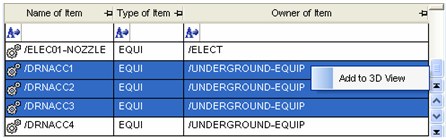

Notice that there are two different context menus available on the grid. One is available when equipment items are selected:
And the other menu is available from the header bar at the top of the grid:
