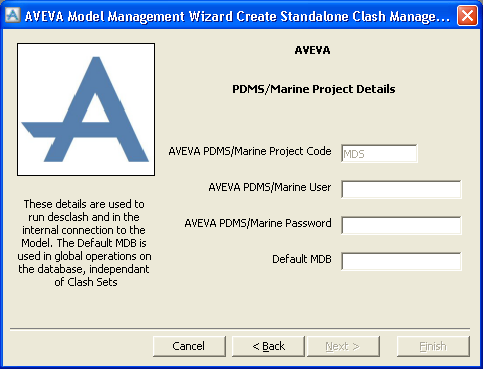

The administrator will then need to enter the AVEVA PDMS/Marine Project Code, AVEVA PDMS/Marine Username and Password and specify a default AVEVA PDMS/Marine MDB.
Select the
Next
button to display the
Clash Manager Project Details
form.

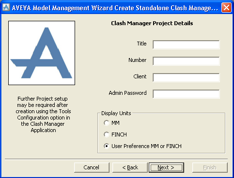

The administrator will have to enter a Title, Number, Client name and an Admin Password for the Clash Manager project.
Select the
Next
button.

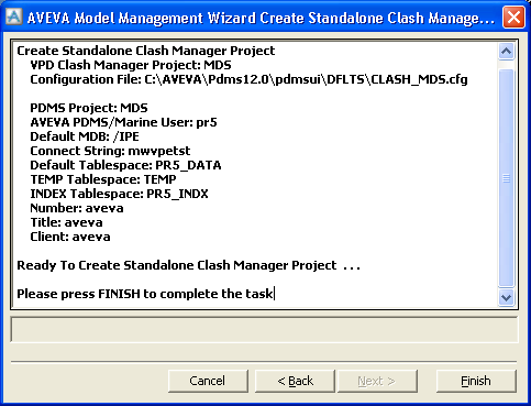

The Wizard displays the information about the project and Clash Manager project, giving the administrator the opportunity to cancel the process. If the administrator continues, remarks on the progress are displayed until it is completed.
