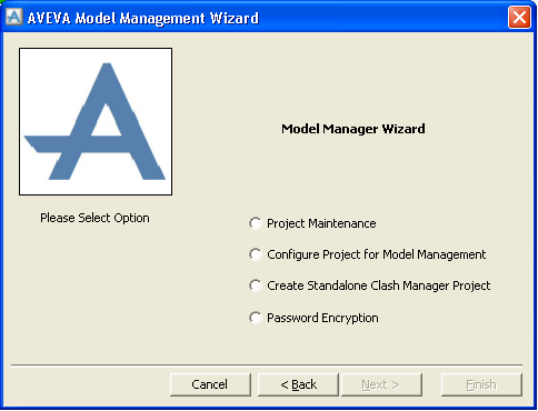

The main menu of the Model Management Wizard looks like this:
The options available are:
Project Maintenance
Allows the user to maintain a project
Create Standalone Clash Manager Project
Creates a Standalone Clash Manager project
Password Encryption
Allows automated Logins to be used
