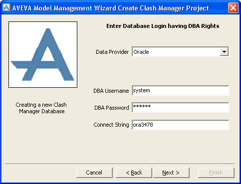

When selecting the Oracle option from the
Data Provider
drop-down menu the form shown is displayed.
The administrator will have to enter the DBA Username and Password, and the Connect String.
Select
Next

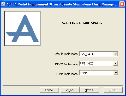

to display the
Select
Oracle TABLESPACEs
form.
The administrator will have to enter the Default Tablespace, INDEX Tablespace and a TEMP Tablespace.
Select the
Next
