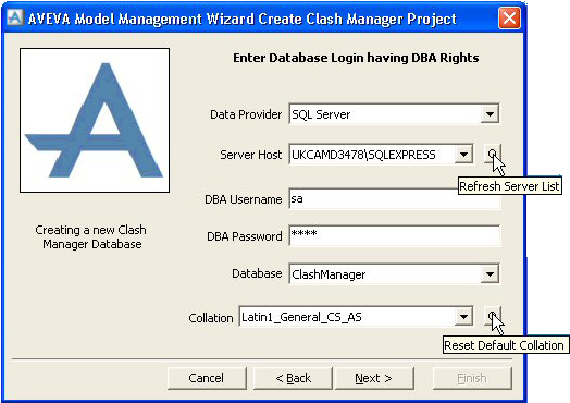

When selecting the SQL Server option from the Data Provider drop-down menu the form shown is displayed:
The administrator will have to select the Server Host (the server list can be refreshed by clicking the button to the right), enter the DBA Username and Password, and select a Database and Collation (which must be Case Insensitive - click the button to the right to reset the Default Collation).
