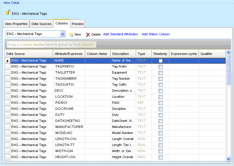

The Columns tab displays the columns definitions for the Database View. A column can be based on a database attribute or expression. Attribute columns are editable in the Database View by the user unless the Readonly property is set. Columns based on expressions are not editable by the user when accessed in the data grid. It may be helpful when managing the columns to drag the Data Source field onto the grouping section in order to quickly see what columns are defined from the different Data Sources.
From the View Detail pane of the Database Views Editor window, select the Columns tab. The columns definitions for the Database View are displayed.
The drop-down list at the top of the Columns tab control contains the all the Data Sources defined in the grid. The functionality of the toolbar which contains the New, Add Standard Attributes and Add Status Column options are affected by which Data Source is selected from drop-down list.
Creates a column definition for the selected Data Source and selects it in the grid.
Adds all of the common attributes for the elements of the selected data source. Add Standard Attributes is enabled if columns don't already exist for all of the common attributes and the element type for the selected Data Source can be identified.
Adds a column to display the status for the selected Data Source. The Qualifier must then be set for the column to the status definition to present to the user.
