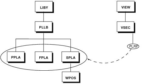

To use a plane to produce a sectioned VIEW, you need to create a View Section (VSEC) element under a VIEW; VSEC attributes are:
PLRF (Plane Reference) - the name of the plane to be used.
