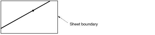

A constructed line in this context is a STRA element whose endpoints lie on the SHEE boundary. Starting with a STRA as the current element, a constructed line is created using the CONLINE command to define a Through point (which may be any of the position options, refer to Dimensioning for further information) and an angle. For example:
Figure 19:18.
