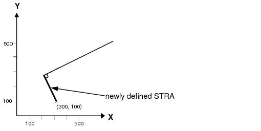

1.
NEW STRA
FPT X300 Y100
TPT X300 Y100 PERP PREV STRA
Here, the STRA has one endpoint defined explicitly and the other defined as the intersection of the perpendicular from the specified reference point to the previous STRA in list order. Refer to
Figure 19:16.: Use of the PERPENDICULAR Construction
for further information.
Figure 19:16.
Where the specified primitive is a line, the constructed point may lie beyond the ends of the line (as above).

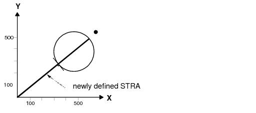

2.
NEW STRA
FPT X0 Y0
TPT X0 Y0 PERP PREV CIRC QUAL @
Here, two constructed points are possible and so a qualifying cursor hit is used.

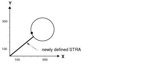

3.
NEW STRA DEF X0 Y0 PERP @ X0 Y0
Here, the cursor hit selects the primitive and acts as a qualifier.

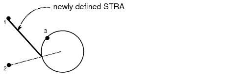

4.
NEW STRA DEF @ @ PERP @
In this case, the first cursor hit defines one endpoint of the STRA, the second defines one end of the line that intersects the circle, and the third picks the circle (and also acts as a qualifier).
