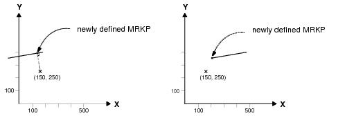

Example
1.
NEW MRKP
DEF NEAREST PREV STRA QUAL X150 Y250
In the left-hand case shown below, the MRKP element and the position (X150, Y250) lie on the perpendicular to the STRA. In the right-hand case, the MRKP lies at the endpoint of the STRA. In both cases, the MRKP element is the nearest point that lies on the previous STRA in the list order to the given qualifying point.
Figure 19:9.
Use of the NEAREST Construction (1)

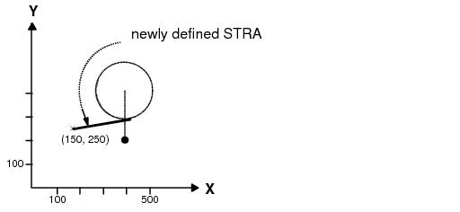

2.
NEW STRA
FPT X150 Y250
TPT NEAREST PREV ARC QUAL @
Here, the STRA has its ‘from’ point defined explicitly, its ‘to’ point being defined as the nearest point which lies on the previous ARC in list order to the given qualifying point.
Figure 19:10.
Use of the NEAREST Construction (2)
