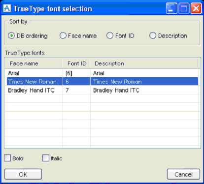

The codes above apply only to intelligent text rendered using a TrueType font. They are not treated as codewords when the AVEVA font is in use. If one of the above codes is used, when the corresponding style is already set as requested by the codeword, it is not treated as a codeword.
Note:
The TrueType font assigned to the element can be set upfront as Bold or Italic without having to use the above codes in the string, when selecting a True Type font from the selection form:
