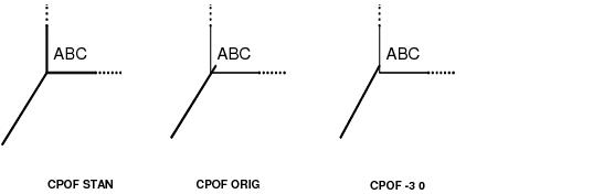

The Leader Line connection point can be offset from its standard position using the CPOF (Connection Point Offset) attribute. This is STANDARD by default, which causes DRAW to determine the actual leaderline connection point. Other settings are ORIGIN, which puts the connection point at the Label origin, or an explicit 2D value, which offsets the connection point relative to the Label origin. Refer to Figure 12:11.: Varying the Leader Line Connection Point for further information.
