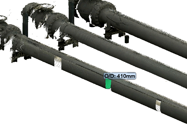

On the Laser tab, in the Measure group, click Pipe O/D, which allows the user to click on the surface of a pipe and examine the laser data and reports the O/D of the pipe. To exit the Pipe O/D mode press ESC on the keyboard.

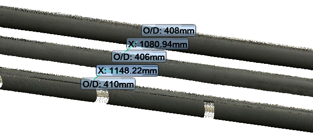

On the Laser tab, in the Measure group, click Pipe Clearance to report the separation between pipes in the primary axis and report O/D of the selected pipes, to exit Pipe Clearance mode press ESC on the keyboard.
