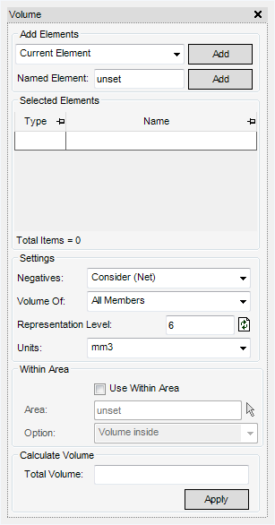

On the Tools tab, in the Model Query group, click Volume to display the Volume window.
Each of the Model Query group windows are divided into parts, these are common to Weight CofG, Area and Volume.
The Selected Elements grid is a multi select list of elements. Right-click on a selection to display a pop-up menu with the following options:
The lower part of the windows has options for specific Mass Property Settings. The main Settings determine if the calculations are to consider negatives (holes/cut-outs):

To calculate any of the settings applied in the Volume, Surface or Weight and Centre of Gravity window the user must click Apply.
