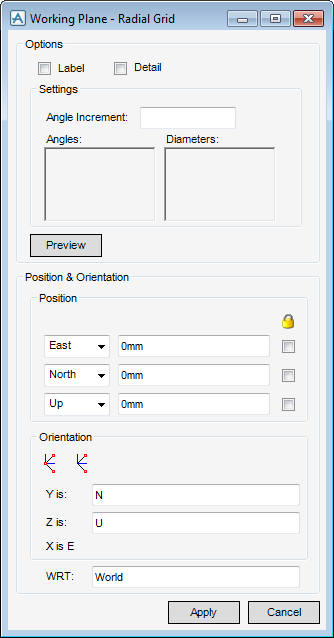

From the Working window select Define > Radial Grid to display the Working Plane - Radial Grid window. If the user has previously defined a radial grid, the window displays the parameters of the existing grid. Changing the values on the window redefines the grid.
The Options pane displays the following:
Select Label check box to label the plane with the text 'Grid'.
Select Detail check box to label the individual gridlines.
The Settings pane displays the following:
Refer to Explicit Position Window for further information.
The Orientation pane displays the following options:
Click Through three Points icon to define the orientation, pick three points anywhere on the model. The orientation defined by the three points defines the orientation of the plane. The plane is orientated but its origin is not moved.
Click Through origin and two points to the define the orientation, pick to points. The plane is rotated so that its X axis is orientated in the direction of the first point and its Y axis in the direction of the second point. The plane is rotated about its origin.
Click OK to confirm changes or click Cancel to discard any inputs.
