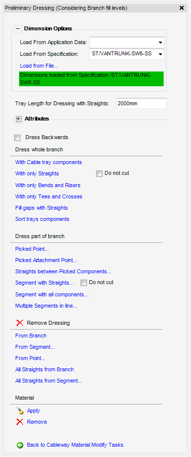

The Preliminary Dressing (Considering Branch fill levels) window allows the user to change attributes of the dressing, dress the whole or part of the branch or remove the dressing from the branch with consideration to branch fill level.
To display the Preliminary Dressing (Considering Branch fill level) window, from the Preliminary Dressing part of the Modify Material window. Select Dimensions based on branch fill levels.
The Preliminary Dressing (Considering Branch fill levels) window has the same common layout as the Preliminary Dressing (User defined Dimensions) with the exception for the Attributes part of the window.

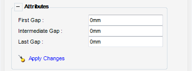

In First Gap, enter the size of the gap before every material component. (Except where there are two adjoining straights).
In Intermediate Gap, enter the gap distance between all adjoining straights.
In Last Gap, enter the size of the gap after every material component except where there are two adjoining straights.
