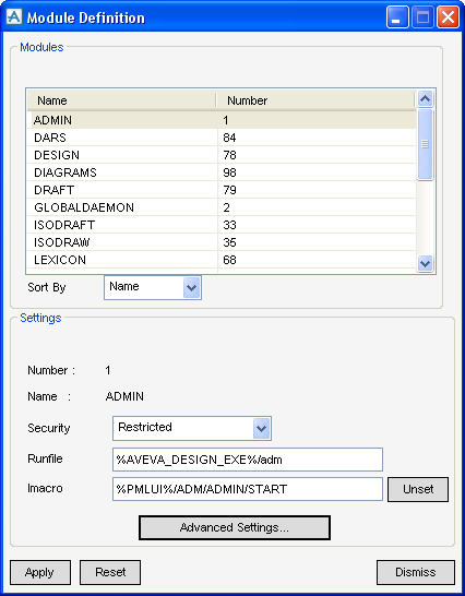

The Module Definition form is displayed when you select Project > Module Definitions from the main Admin menu bar. This form allows you to create and edit modules definitions for the current project.
The Modules pane lists the AVEVA E3D™ modules.
The Sort by gadget controls the order in which modules are displayed in the list.
The Settings pane displays the settings for the module selected in the Modules list. You can change all of these except the Number and Name.
Security can be set to Restricted, General or Free.
Runfile sets the file used to start up the module. The defaults are supplied in the %AVEVA_DESIGN_EXE% directory.
Imacro sets the file used to start up the GUI for the module. The default is given by the %ADMSTART% variable.
Advanced Settings displays the Advanced Module Settings form. This form allows you to set the buffer size (see next section), the default database type and access for the module.
