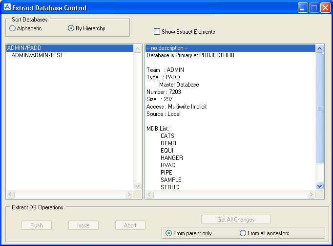

If you select
Data > Extract Database Control
you will see the
form
The left-hand list shows all the extract databases in the project (including master databases): you can use the Sort Databases options to sort the list Alphabetically or to show the extract Hierarchy.
The right-hand list shows information about the database selected in the left-hand list. If you switch on Show Extract Elements at the top of the form, the list will also show the elements extracted to this DB.
The Extract DB Operations buttons at the bottom left of the form allow you to flush, issue or abort all changes to the selected DB. The Get All Changes button at the bottom right of the form allows you to refresh an extract DB. Use From parent only to refresh an extract DB with changes from its parent extract only, or use From all ancestors to fully refresh an extract DB with changes made from all its extract ancestors. Using From all ancestors will consequently update the intermediate ancestors.
