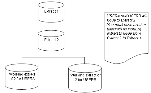

When you issue data from a working extract, it will be issued to the database from which the working extract has been created.
In order to issue data from an extract which has working extracts to an extract further up the extract tree, there must be a user who does not have a working extract: see the following diagram.
Note:
You cannot issue changes from working extracts without first releasing the user claim.
Working extracts are never included in MDBs, but are substituted for their parent extract automatically as a user selects the MDB. For example, if the parent extract is aaaa/bbb, then when a user with the working extract uses an MDB containing aaaa/bbb, the working extract will be used automatically instead of aaaa/bbb. Although working extracts do have names, it is not necessary to know it when working in MODEL. When in ADMIN, the working extract name is applicable for commands such as CHECK,
