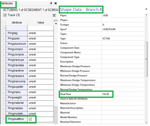

Pipeline, branch and tube element types need to be added for one pseudo attribute in Lexicon so that this will be available in Diagrams Attributes. The pseudo attribute name is PmgDualFlow. In the below window the pseudo attribute is available in the Diagrams Attributes and Shape Data windows.

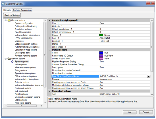

In Diagrams Options there is an option to set the line pattern to Dual flow. This option is available in Element options > Pipeline options > Dual Flow Line Pattern Name. By default this option is set to Custom Line Pattern which is available in the default project AVEAV Dual Flow dir.

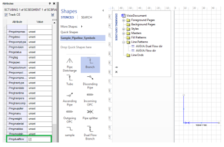

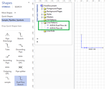

Drag and drop the dual flow branch master shape on to the drawing before setting the line pattern to Dual Flow Line Pattern. The line pattern is added to the drawing. If the line pattern is not added to the drawing, it is not possible to set the pipeline to dual flow.

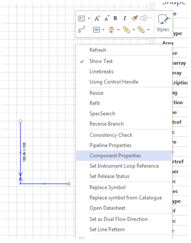

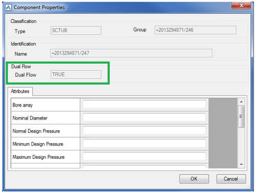

Use the context menu Set as Dual Flow Line Pattern to set the single flow line to dual flow line. Once the line is set to dual flow the pseudo attribute in Lexicon changes the state to True.
Right-click on the context menu Component Properties to check whether the pipe is set to single or dual flow.
