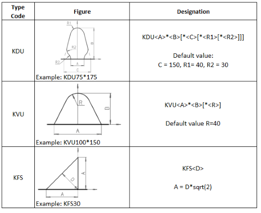

Built-in Standard Notches

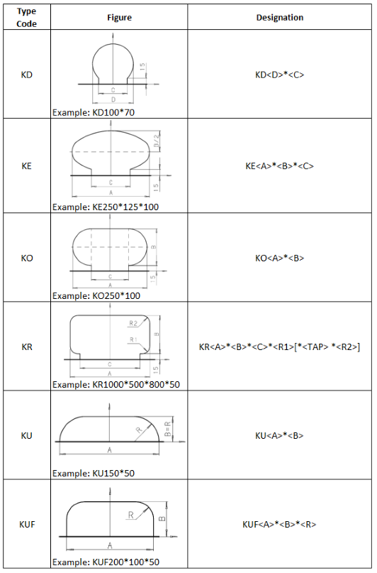

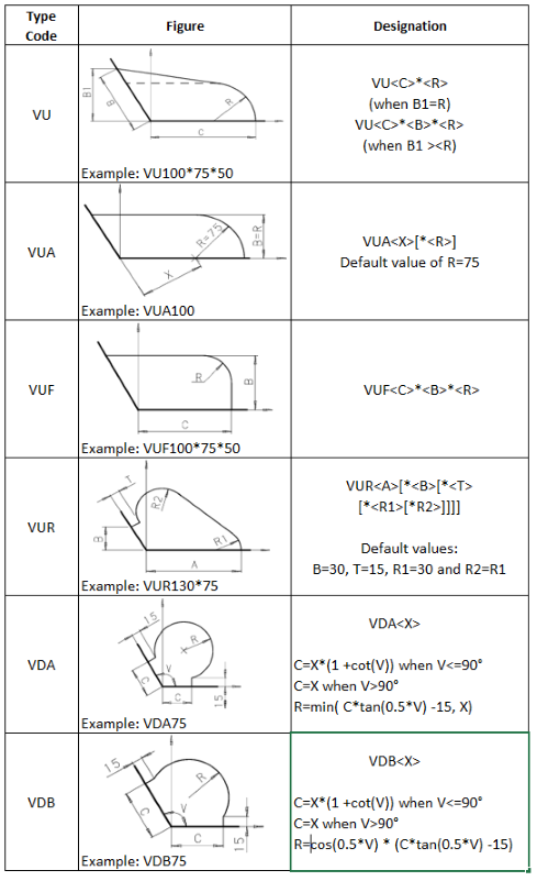

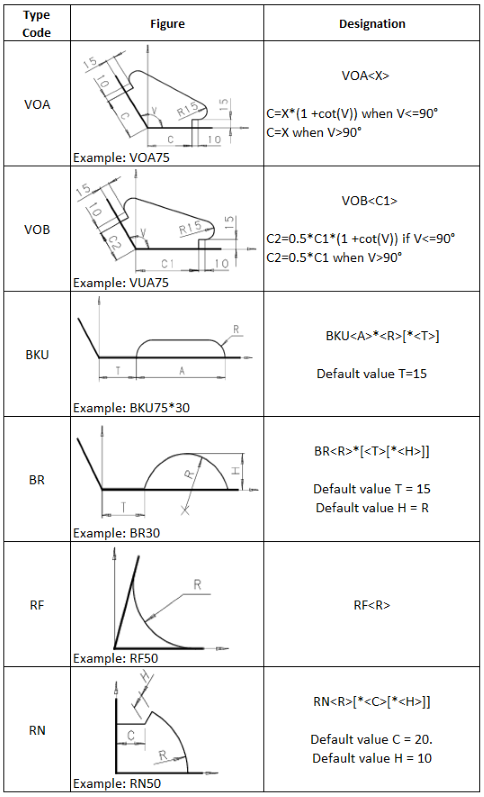

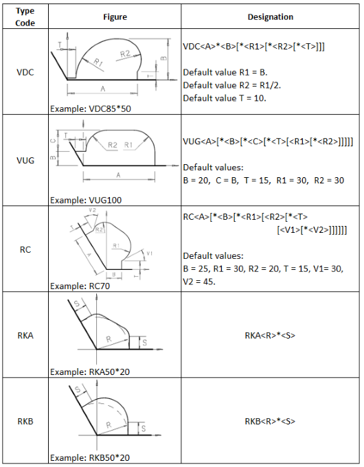

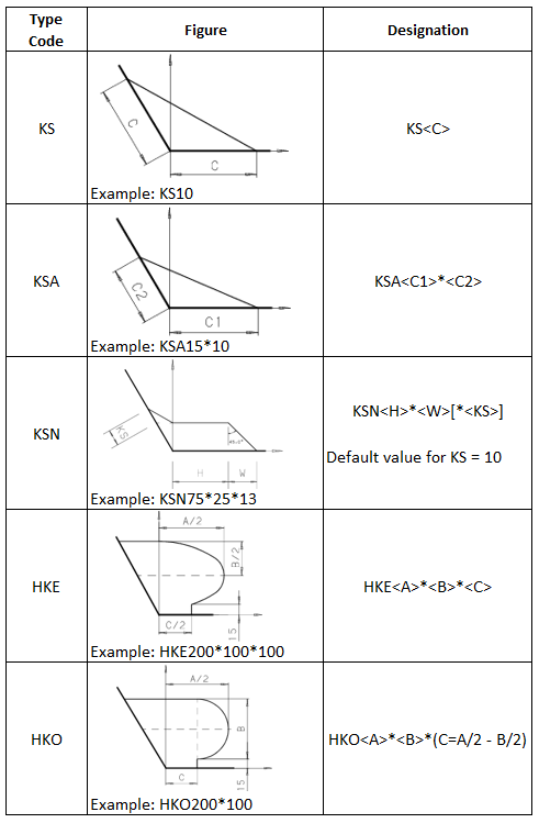

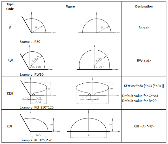

A standard hole in Hull Design is defined by a hole designation (string) and parameters. The built-in standard is presented in tables below.
Corner and Edge Notches
Corner Notches
Edge Notches
