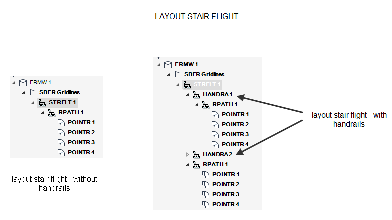

When the STRFLT element is created in the layout mode, below the STRFLT level in SLH hierarchy, the SLH specific elements are:
HANDRAIL (HANDRA)
HANDRA elements are only available for selection during the creation of a Layout STRFLT element. The creation of all other handrails is a separate task, for more information refer to
Handrails
ROUTE PATH (RPATH)
The Routing Path element defines an open path or closed boundary using the following:
Free form sketching
Tracing existing profiles or boundaries.
ROUTE POINT (POINTR)
POINTR elements are significant point references which form the RPath.
