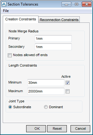

When a joint which has one or more attached sections is repositioned, the effect on those sections depends upon whether or not the joint has been defined as dominant or subordinate, as defined by the setting of the joint’s Joint Freedom (JFRE) attribute.
The standard default is for joints to be subordinate. The default can be changed by the selection of
Section tolerances.
On the
SECTIONS
tab, in the
Settings
group, click
Tolerances
to display the
Section Tolerances
window.
