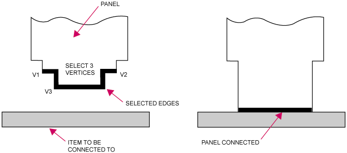

Connect selected edges to the selected item to be connected to. If the vertices describing the edges do not align with the selected item they are modified to align. Relative geometry between the selected edges is not maintained.
