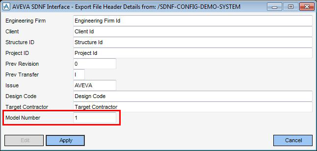

For Export, the model number that is output in the SDNF file is retrieved from the header object and can be set using the modified dialogs illustrated below.
