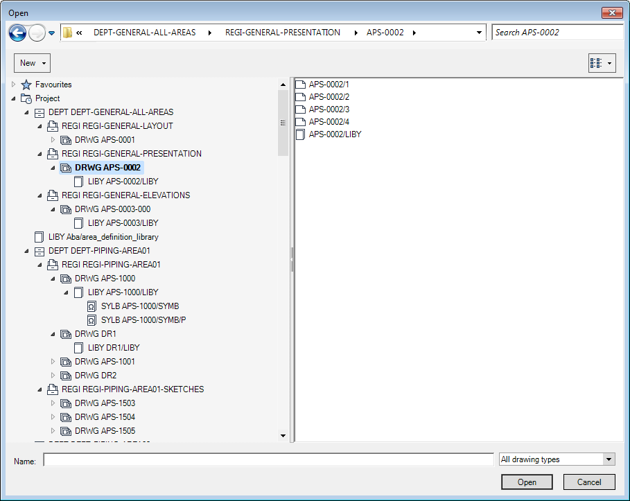

To create a drawing sheet with the Hierarchy Browser window, on the Project tab, click Open to display the Open window. The functionality to create a department, registry or drawing with the Open window is identical to Hierarchy Browser window.

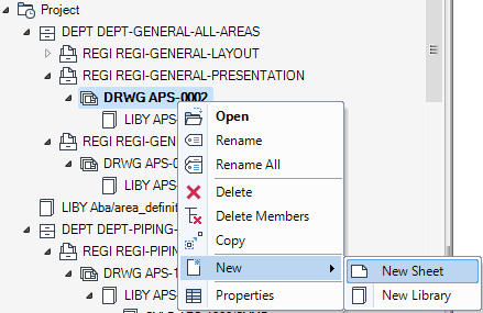

To create a drawing sheet (SHEE) element, on the left-hand part of the Hierarchy Browser window, right-click the DRWG element that the SHEE element is to be created in and select New > New Sheet from the drop-down list.
Alternatively, in the right-hand part of the Hierarchy Browser window, select an existing SHEE element, right-click and select New > New Sheet from the drop-down list.
The SHEE element is created and displays in the Hierarchy Browser window. The user can then input a name for the sheet.

Select the DRWG element that the SHEE element is to be created in and click New. The user must then select New Sheet from the drop-down list.
The SHEE element is created and displays in the Hierarchy Browser window. The sheet is assigned a default name of the drawing name followed by /S and the next available number.
