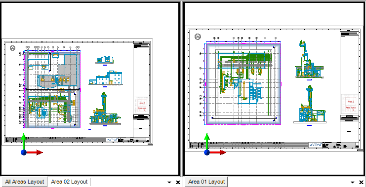

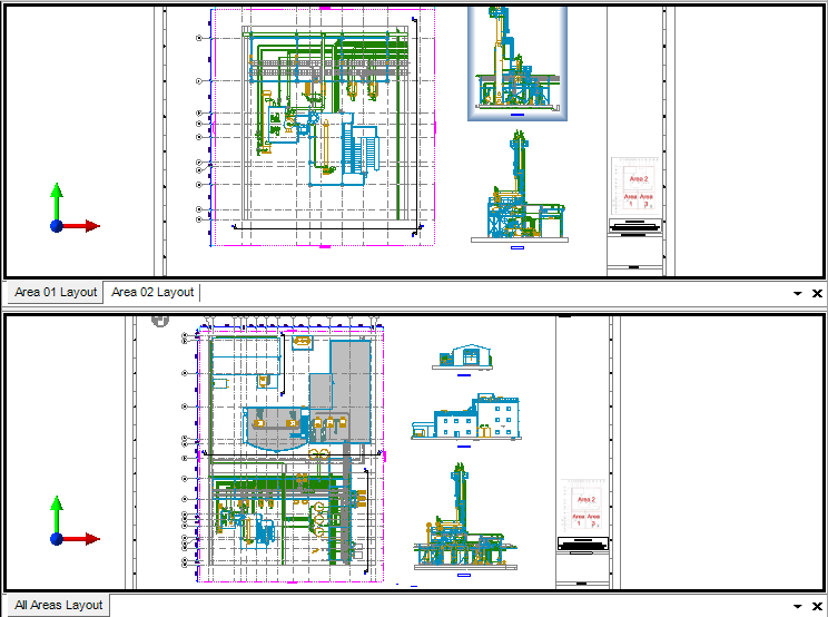

The tab view of open drawings can be grouped to display the drawings in a split horizontal or vertical window.
To create a new horizontal tab group, right-click the drawing tab to be viewed in a split window and select
New Horizontal Tab Group
from the drop-down list.
The drawing tab displays in a split window and a tab group is created.
To create a new vertical tab group, right-click the drawing tab to be viewed in a split window and select
New Vertical Tab Group
