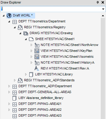

The Draw Explorer provides a graphical method for using the Draw Database. On the Tools tab, in the Explorer group, click Draw Explorer to display the Draw Explorer.
Click to display the Attributes window. Refer to Attributes Window for further information.
Click to add the selected element to the list in the Collections window. Refer to Collections for further information.
Click to add members from the selected element to the list in the Collections window. Refer to Collections for further information.

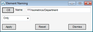

To rename an element, on the Draw Explorer, right-click the currently selected element and select Rename from the drop-down menu to display the Element Naming window.
The Element Naming window allows the user to rename the selected element and its members.
Note:
Re-name all is recommended to rename the entire hierarchy below the currently selected element.
Click Reset to revert to the values applied when the Element Naming window was opened.
Click Apply to confirm the modifications or Dismiss to discard any changes and close the Element Naming window.
