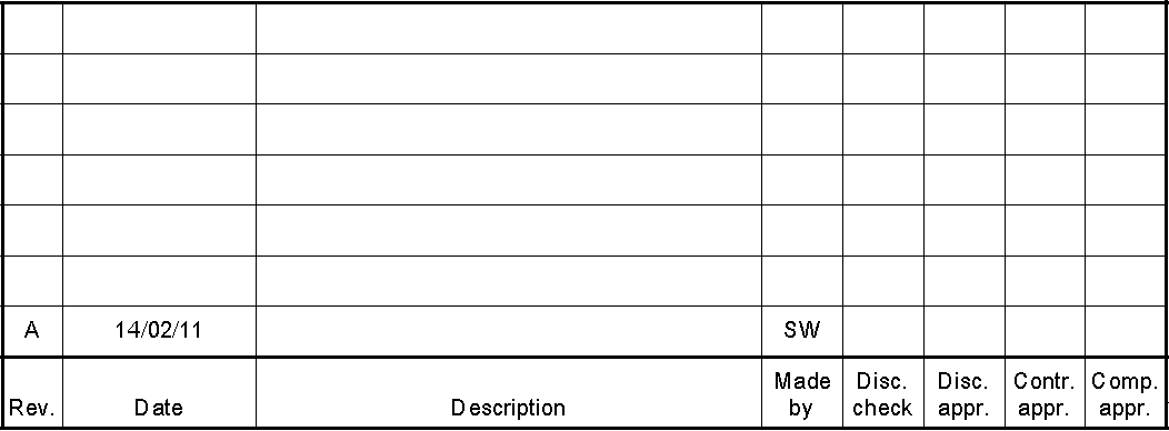

The Revision Table contains information about the current Issue of the Isometric Sheet.
During creation or update of the sheet, the Revision value is applied. The administrator configures the revision system used, refer to
Revision
for further information. The date of creation or update is included as well as the name of the author.
Each row in the table reflects the settings of each REVI element stored below the sheet, with each cell being a TEXT element. The user can change each cell individually, if required, but the complete table can be easily modified, refer to
Modify Drawings
