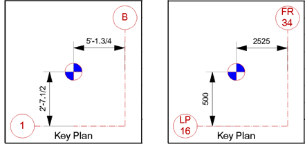

: Keyplan
Keyplan
The keyplan provides the origin location of the currently drawn Spool within a current grid system. The administrator configures the grid system used. The nearest grid lines display, the distance to them is indicated with dimensions in the relevant units.
Note:
Because the keyplan is not to scale, the dimensions display the grid offset values using the Linear Dimension attribute DMTX, the grid offset values are calculated, not extracted from the 3D model.
