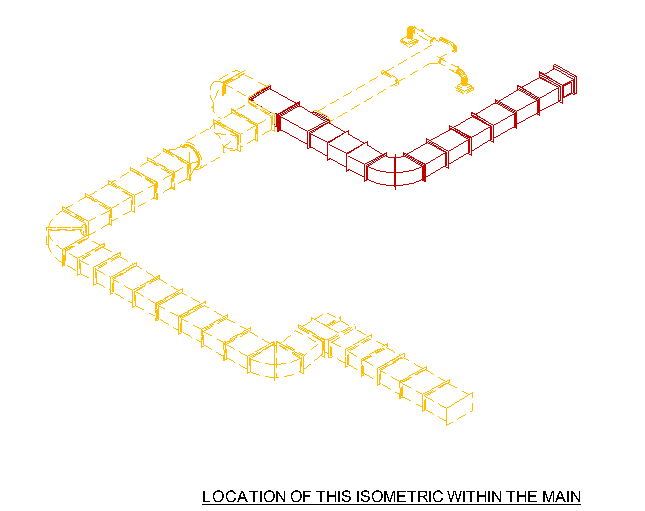

: Location Plan
Location Plan
The Location Plan indicates the relationship between the currently drawn Spool and the complete HVAC Main or Cableway. It is a standard View so the user can manipulate it or annotate it as with any other DRAW View.
