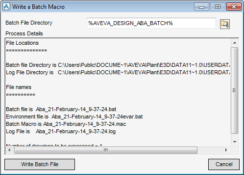

Select the Batch Process check box and click OK, to display the Write a Batch Macro window, the user can specify the location of the files.
A standard Browse for Folder window displays. The user must specify the folder into which the batch files are to be located and click OK to proceed with the export.
The Write a Batch Macro window gives details about the files to be created. To continue with the process click Write Batch File.
Once complete, a Message window displays, informing the user of the location of the batch process log file. Click OK to dismiss the Message window.The files created by the batch process are:
