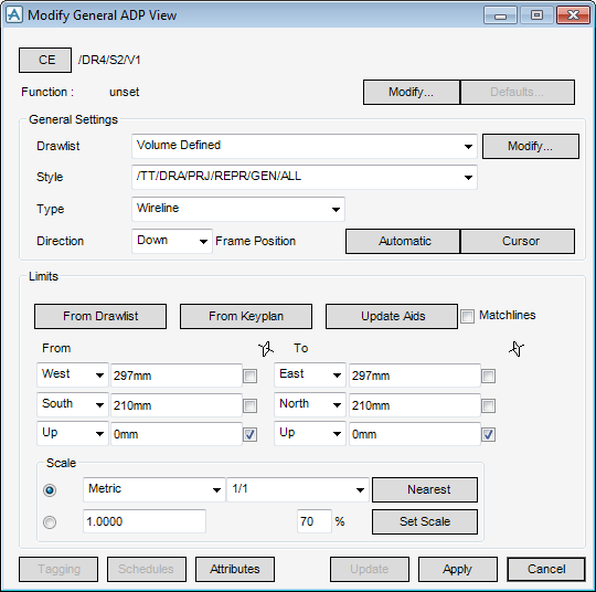

ADP views are modified using the Modify General ADP View window. By default, the Modify General ADP View window displays when an ADP view is created (refer to Create General ADP Views for further information).
Alternatively, the user can modify an existing view. To modify the currently selected view, on the Auto tab, in the Modify group, click General, select View from the drop-down list to display the Modify General ADP View window.
The Modify General ADP View window allows the user to define the drawing view based on general settings and limits imposed either by the drawlist or keyplan.
Select how the Drawlist is defined from the drop-down list. For example select Volume Defined to define the drawing using the values in the direction boxes at the bottom of the window.
Click to display the Drawlist Management window. Refer to Define View Contents for further information.
Input dimensional values in the From direction fields to define the limits of the view explicitly.
The direction can be defined in East, West, North, South, Up and Down directions using the drop-down lists.
Input dimensional values in the To direction fields to define the limits of the view explicitly.
Select Metric from the drop-down list to scale the drawing using metric values. For example, 1/1.
Select Architectural from the drop-down list to scale the drawing using architectural values. For example, 1 1/2” = 1’-0”.
Select Engineering from the drop-down list to scale the drawing using engineering values. For example, 1” = 10’-0”.
Click to display the ADP Tagging window. Refer to ADP Tagging. for further information.
Click Apply to modify the ADP view or Cancel to discard any inputs and close the Modify General ADP View window. On completion of the creation process, the drawing view displays.
